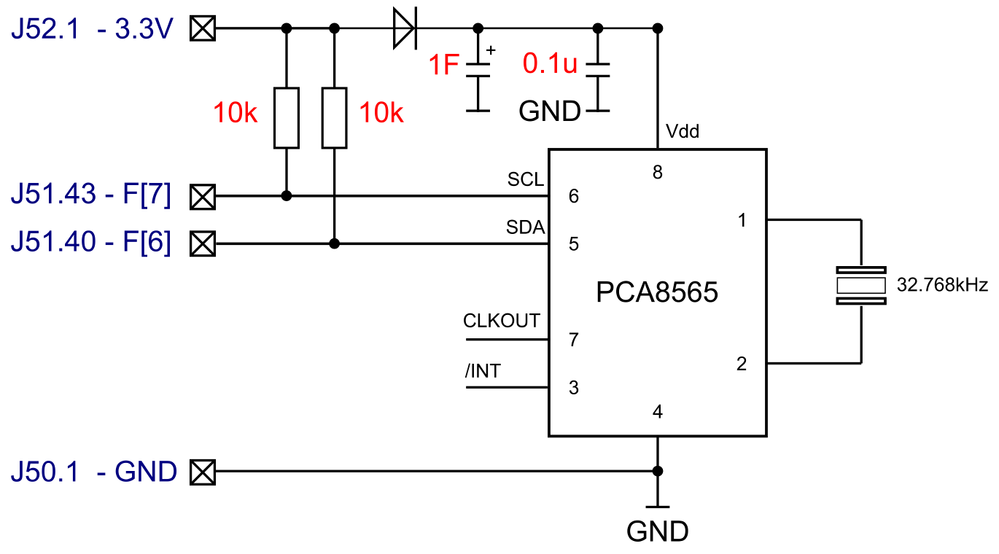

Detailed Description:
Demo application performs I2C communication with externally connected external
real time clock/calendar PCA8565. Obtained values and processed and displayed
on MPC5606S-DEMO-V2 board’s TFT panel. Date and time may be set up by demo
board’s buttons (SW2-SW6).
Application uses standard Graphics Libraries for MPC5606S for simple graphic
output that is managed in mc_base.c module only.
I2C communication is managed with using of own two layer driver where
low-level driver consisting of I2C_0.c and I2C_0.h - these can be used for
any device connected to I2C_0 module.
Middle-level driver layer consist of I2C_PCA8565.c and I2C_PCA8565.h and it
is specific to PCA8565 device.
Test HW:            MPC5606S-DEMO-V2 + LM75BD + HIH-5030 + PCA8565 sensors
MCU:             PPC5606SEF OMLU 0M25V DD68391 XOTAC1003
Fsys:            64MHz
Debugger:        Lauterbach Trace32
Target:          internal_FLASH
Terminal:        none
EVB connection:
For complete project you may see following link:
Demo application MPC5606S-DEMO + LM75B + HIH-5030 + PCA8565 + GUI
