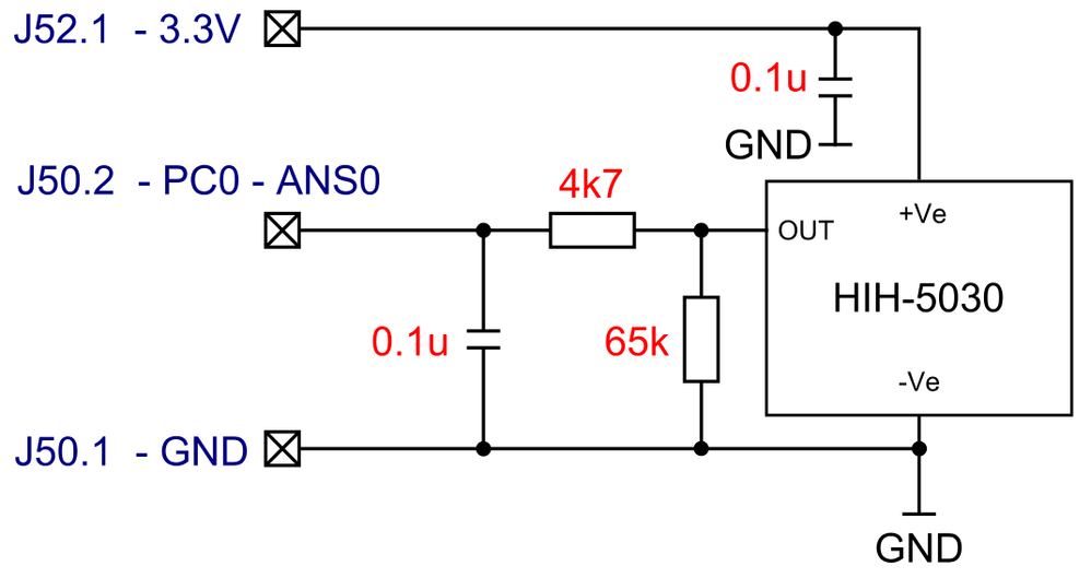

Detailed Description:
Demo application measures analog voltage from externally connected humidity
sensor HIH-5030. Obtained values and processed and displayed on
MPC5606S-DEMO-V2 board’s TFT panel.
Application uses standard Graphics Libraries for MPC5606S for simple graphic
output that is managed in mc_base.c module only.
Test HW:            MPC5606S-DEMO-V2 + HIH-5030
MCU:             PPC5606SEF OMLU 0M25V DD68391 XOTAC1003
Fsys:            64MHz
Debugger:        Lauterbach Trace32
Target:          internal_FLASH
Terminal:        none
EVB connection:
For complete project you may see following link:
Demo application MPC5606S-DEMO + LM75B + HIH-5030 + PCA8565 + GUI
