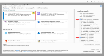

Jorge_Gonzalez
Hello Nic,
I had the same error during SPSDK installation and I also installed Microsoft Visual C++ manually, then it was solved.
Did you install the C++ x64/x86 build tools and Windows SDK as indicated in this link?
Below is a screenshot from the options I selected in the Visual Studio Build tools installer (Windows 10 SDK in my case):
Regards!
Jorge Gonzalez

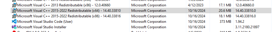

Nic_Roozeboom
I manually installed Microsoft Visual C++, rebooted my machine, re-ran the script "pip install -U spsdk" but it still terminates in the same error.
Then, re-ran "pip install --upgrade setuptools" and did the install again, same result.
(GetSpsdk) C:\Users\usb01768\GetSpsdk\Scripts>pip install --upgrade setuptools
Requirement already satisfied: setuptools in c:\users\usb01768\getspsdk\lib\site-packages (75.2.0)
I verified that I have Microsoft Visual C++ >v14.0 installed:
This is getting very frustrating.
Do you have any other ideas as to what might be the cause, and solution?
I also feel like there should be a check / update step in the Prerequisites document to prevent users from running into this.
Thanks very much!

Jorge_Gonzalez
Hello Nic,
Regards!
Jorge Gonzalez

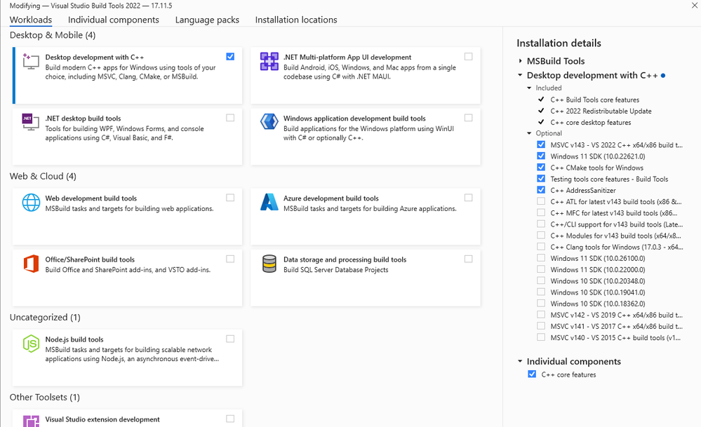

Nic_Roozeboom
Hi Jorge and team,
Just re-installed Visual C++ with the modified attributes, and now pip install -U spsdk completes without error. Thanks for helping resolve this!
I would recommend to add a check early on in the Prerequisites document, to prevent this corner case for some users, as it is time-consuming to correct late in the process (including requiring reboots, which doesn't help efficiency either).

Nic_Roozeboom
Hi Jorge, thanks for your reply! It's encouraging that you found and fixed the issue.
I will modify my Build Tools install as below. This will take some time, so likely will revisit tomorrow.
