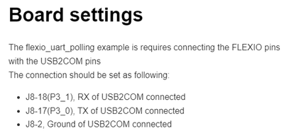

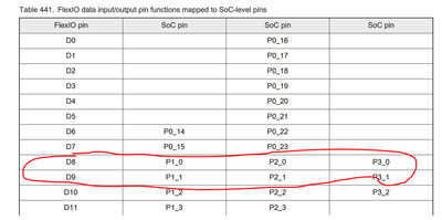

I'm looking the "flexio_uart_edma_transfer" of frdmmcxn236 in code FLEXIO_UART_TX_PIN is "FLEXIOD8"  and FLEXIO_UART_RX_PIN is "FLEXIOD9"
In MCXN23X Reference Manual(page 2112, chapter 53.1.2),"FLEXIOD8" mapped to the pin P3_0 and "FLEXIOD9" mapped to the pin P3_1, so that means FLEXIO_UART_TX_PIN is P3_0  and FLEXIO_UART_RX_PIN is P3_1.
However in the readme file of "flexio_uart_edma_transfer" P3_1 is connected to the rx pin of USB2COM and P3_0 is connected to the tx pin of USB2COM.  RX pin of FLEXIO_UART is connected to the RX pin of USB2COM and TX pin of FLEXIO_UART is connected to the TX pin of USB2COM.  Is this the right connection?

Thanks for contacting us. The content in readme file is wrong. The correct is:
  • J8-18(P3_1), TX of USB2COM connected
  • J8-17(P3_0), RX of USB2COM connected
  • J8-2, Ground of USB2COM connected
I will create a Jira ticket for the internal team for this issue.
