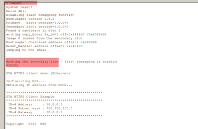

Hi @drb55 ,
I'm sorry for the trouble this error has caused you, and for that I sincerely apologize. And thank you for pointing out this discrepancy.
I received a response from the internal team regarding this issue:
This difference is due to the use of the remap function. For platforms like RT1050 and RT1020, they do not have a remap function, so mcuboot needs to move the image from slot2 to slot1. but for platforms that support the remap function, you can choose which slot to jump to by simply enabling or disabling the remap function. Due to the SDK readme generation mechanism, it caused the doc issue.
In the meantime, the issue has been reported and will be fixed in a later released version.
Wish you a nice day.
Gavin

Hi @drb55 ,
Thanks for your interest in NXP MIMXRT series!
I have tested with RT1060EVK on my side, it should be same as RT1170 except the flash address.
Please confirm a few points:
1. Signed application images directly programmed into flash memory by a programmer require additional "--pad --confirm" parameter for imgtool. This parameter adds additional trailer to the signed image and is required by bootloader direct-xip process (see MCUBoot documentation for more information). Signed images used in OTA process do not require "-pad" parameter.
2. Use Jlink to flash the signed client's image to flash at address 0x3004_0000 instead of 0x3004_0400.
I read your log and found that slot0 is always EMPTY, which is not correct.
Here is my log:
Following the steps should result in good news.
Gavin

Hi @drb55 ,
I think your operation should be successful. How do you tell if the operation was successful? By the version information of the two images? I don't see reboot in your second operation.
For me, the distinction is made by two identical IMAGES, with only the difference in print information.(V1 or V2)
image test 0 --> reboot --> image --> image accept 0
On the success of the Reboot step, the candidate image is executed. The subsequent steps are simply to remove the header of the inactive IMAGE.
Gavin

Bootloader chainload address offset: 0x240000
Reset_Handler address offset: 0x240400
Jumping to the image
Booting the secondary slot - flash remapping is enabled
OTA HTTPS client demo  V2V2V2 (Ethernet)
Initializing PHY...
Obtaining IP address from DHCP...
OTA HTTPS Client Example
IPv4 Address     : 10.1.15.110
IPv4 Subnet mask : 255.255.255.0
IPv4 Gateway     : 10.1.15.1
Copyright  2022  NXP
$ image info
Image 0; name APP; state Testing:
  Slot 0; slotAddr 30040000; slotSize 2097152
    <IMAGE APP_PRIMARY: size 253664; version 2.1.0.0>
 Slot 1; slotAddr 30240000; slotSize 2097152
    <IMAGE APP_SECONDARY: size 253664; version 2.2.0.0>
$ image accept 0
Deleting header of inactive image in primary slot (downgrade support for direct- xip)
$ hello sbl.
Disabling flash remapping function
Bootloader Version 1.10.0
Image 0 Primary slot: Image not found
Secondary slot: version=2.2.0+0
Image 0 loaded from the secondary slot
Initializing PHY...
Copyright  2022  NXP
$ image info
Image 0; name APP; state Permanent:
    <EMPTY>

Hi @drb55 ,
