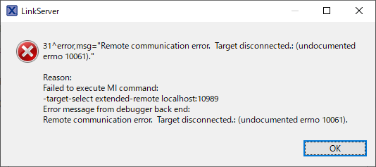

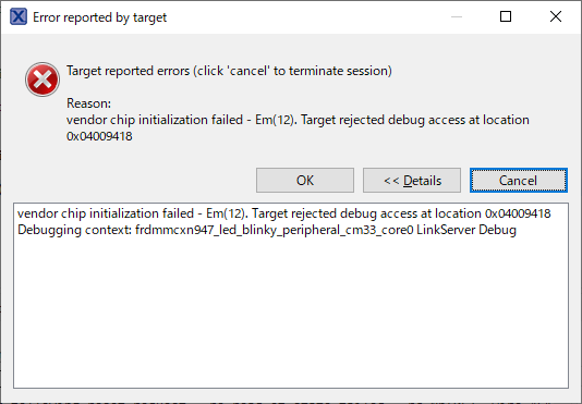

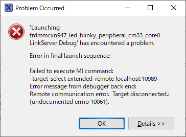

I am using the FRDM-MXCN947 board and am trying to write to QSPI Flash from the download during debugging in MCUXpresso IDE, but the following error occurs.
The flash driver uses MCXN9xx_SFDP_FlexSPI.cfx.
Do I need to modify the driver?
Thank you.

takagi_y
Thank you for your reply.
It is now possible to write to Flash from the IDE using XIP with FRDM-MXCN947.

Hi @takagi_y
If you want to run code from external memory,
You can refer to this article
Running code from external memory with MCX N94x - NXP Community
Harry

takagi_y
I have checked the article you introduced.
In this case, you need to start the board in ISP mode.
Is it possible to write to the QSPI Flash by downloading (debug) from the MCUXpresso IDE like the RT1060?
If there is a way to write from the IDE, please let me know.

Harry_Zhang
Hi @takagi_y
"Is it possible to write to the QSPI Flash by downloading (debug) from the MCUXpresso IDE like the RT1060?"
Yes, but you need to change the CMPA to boot from external flash.
So first you need to refer to this article to change CMPA.
And then write to the QSPI Flash by downloading (debug).
Harry

Harry_Zhang
Hi @takagi_y
You can also refer to hello_world_qspi_xip example.
