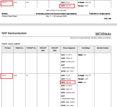

On Data Sheet Reference: MCXNx4xDS.pdf, the pinmux tables for pins P3_23, P3_21, P3_22, and P3_20 do not show any mux assignments for signals CS, CLK, MISO, or MOSI.
On a quick look, it appears the reference manual, MCXNx4xUM.pdf, shows the same information for the pins as the data sheet.
Assistance Requested
I am a new user of NXP MCUs and I am certainly not yet familiar with your documentation. Please help me identify how to configure the pinmux so SPI signals CS, CLK, MISO, or MOSI are sent to the Mikroe connector. Please reference the documentation I should use to obtain the correct pinmux settings.

Hello @ClarkS ,
Thanks for your post. For the content in schematic and UM12018:
  • The J6-3 (CS) wire is labeled as P3_23/ME_FC6_SPI_CS.
  • The J6-4 (SCK) wire is labeled as P3_21/ME_FC6_SPI_CLK.
  • The J6-5 (MISO) wire is labeled as P3_22/ME_FC6_SPI_MISO.
  • The J6-6 (MOSI) wire is labeled as P3_20/ME_FC6_SPI_MOSI.

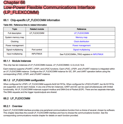

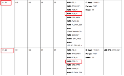

The signal names ME_FC6_SPI_XXX above indicate that these pins belong to the SPI function of the FlexComm module (FC6).
The FlexComm module is a multi-function peripheral supported by MCXN947, which can be configured in modes such as SPI, I2C, and UART.
For example, ME_FC6_SPI_CLK represents the clock pin when the FlexComm 6 module is configured for SPI.
So in the pinmux of the datasheet and MCXNx4xUM.pdf, this can be seen. they are all multiplexed to ALT 3, as shown in the figure below.
For the specific content of FlexComm, you can refer to Chapter 66 in the Reference Manual.
