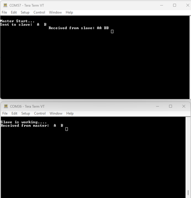

here i am trying to send two byte from master to slave and want slave respond two byte back but
master send proper two byte but slave didnt recieve anything and from slave side master able to
get one byte only.

Hello @ravicha ,
Is the following picture what you want to achieve?
Please see my code below:
master code:
#include "fsl_spi.h"
#include "pin_mux.h"
#include "clock_config.h"
#include "board.h"
#include "fsl_debug_console.h"
#include <string.h>
* Definitions
#define EXAMPLE_SPI_MASTER SPI1
#define EXAMPLE_SPI_MASTER_SOURCE_CLOCK kCLOCK_BusClk
#define EXAMPLE_SPI_MASTER_CLK_FREQ CLOCK_GetFreq(kCLOCK_BusClk)
void spi_cs_low(void) { GPIO_PinWrite(GPIOD, 4U, 0); }
void spi_cs_high(void) { GPIO_PinWrite(GPIOD, 4U, 1); }
int main(void)
spi_master_config_t userConfig = {0};
uint32_t srcFreq = 0;
BOARD_InitBootPins();
BOARD_InitBootClocks();
BOARD_InitDebugConsole();
gpio_pin_config_t cs_config = {kGPIO_DigitalOutput, 1};
GPIO_PinInit(GPIOD, 4u, &cs_config);
spi_cs_high();
PRINTF("\n\rMaster Start...\n\r");
SPI_MasterGetDefaultConfig(&userConfig);
srcFreq = EXAMPLE_SPI_MASTER_CLK_FREQ;
SPI_MasterInit(EXAMPLE_SPI_MASTER, &userConfig, srcFreq);
uint8_t txData[2] = {0x0A, 0x0B};
uint8_t rxData[2] = {0};
spi_transfer_t xfer = {
.txData = txData,
.rxData = rxData,
.dataSize = 2
spi_cs_low();
SPI_MasterTransferBlocking(EXAMPLE_SPI_MASTER, &xfer);
spi_cs_high();
PRINTF("Sent to slave: ");
for (int i = 0; i < 2; i++) PRINTF("%02X ", txData[i]);
PRINTF("\n");
PRINTF("Received from slave: ");
for (int i = 0; i < 2; i++) PRINTF("%02X ", rxData[i]);
PRINTF("\n");
while (1);
slave code:
#include "board.h"
#include <string.h>
* Definitions
#define EXAMPLE_SPI_SLAVE SPI1
#define TRANSFER_SIZE 2
int main(void)
spi_slave_config_t userConfig;
PRINTF("\n\rSlave is working....\n\r");
SPI_SlaveGetDefaultConfig(&userConfig);
SPI_SlaveInit(EXAMPLE_SPI_SLAVE, &userConfig);
uint8_t txData[TRANSFER_SIZE] = {0xAA, 0xBB};
uint8_t rxData[TRANSFER_SIZE] = {0};
for (int i = 0; i < TRANSFER_SIZE; i++) {
while (!(SPI_GetStatusFlags(EXAMPLE_SPI_SLAVE) & kSPI_TxBufferEmptyFlag));
SPI_WriteData(EXAMPLE_SPI_SLAVE, txData[i]);
while (!(SPI_GetStatusFlags(EXAMPLE_SPI_SLAVE) & kSPI_TxBufferEmptyFlag)) {}
rxData[i] = SPI_ReadData(EXAMPLE_SPI_SLAVE);
PRINTF("Received from master: ");
for (int i = 0; i < TRANSFER_SIZE; i++) PRINTF("%02X ", rxData[i]);
PRINTF("\n");
while (1)
BRs,
Celeste
