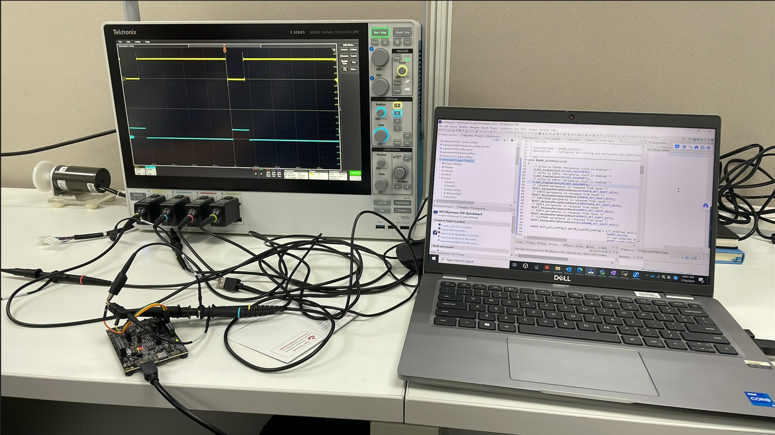

Harry_Zhang
Hi @marks
I tested the pwm example.( SDK_2_16_000_FRDM-MCXA153\boards\frdmmcxa153\driver_examples\pwm)
It can work.
You can check my picture.
Hope this will help you.
Hang
