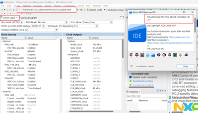

I downloaded and installed the MCXpresso IDE v25.06, and the clock tool works well.
Please install IDE v25.06 again, then re-download the SDK for MCXN236 from the NXP website:
Then import the SDK into the IDE to test again.

Tried this and no luck, same issue. Ran the IDE "As Administrator" and bingo(!) clicking the Tools caused the download of the needed files and the tabs opened as expected. Therefore, the solution (in my case) was: "Run IDE -as admin-" and it worked. Once the files were downloaded, As Admin was no longer needed to continue to work as expected.
