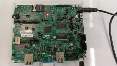

I was debugging a program on RT1170EVKB It was working fine.
While flashing another program something went wrong and then onwards, I am getting the following errors:
Error logs:

Sam_Gao
It seems something error about 'connection?',
Please try to check in doing power-off/on again, or use other USB Cable instead.

Rathore-pioneer
Here is the Board LED status:
