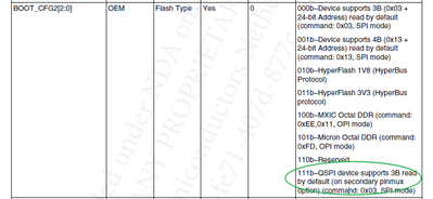

I remember there is another difference. I use the flexspi DQS pin(GPIO_SD_B1_05) as I2C_SDA(I didn't connect that pin to flash). I don't know if it will affect Flash.
3,018 Views
Gavin_Jia
Hi @lsjshengll ,
That should be the issue. If the external flash does not provide the DQS signal, the DQS pin of the MCU should be floated. It cannot be reused as other functions.
Gavin
3,000 Views
lsjshengll
@Gavin_Jia
I have another question: The DQS pin can be routed to two pins (GPIO_SD_B1_05, GPIO_AD_B1_09). Why does using GPIO_SD_B1_05 will affect Flash operation? How does the RT1061 initialization determine this behavior? Do both pins need to be floated? Thank you.
2,986 Views
Gavin_Jia
Hi @lsjshengll ,
The two optional pins of DQS are not used casually. BootROM supports the FlexSPI primary option and the second option, that is, it has two groups of options. The selection method is the configuration in BootCFG2 or eFuse. The default configuration is the primary option.
It should be the FlexSPI primary option on your board, so the corresponding DQS can only be GPIO_SD_B1_05.
