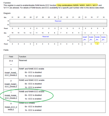

I'm developing on the MCXN947.
Right now, my SRAM starts at 0x20000000 and has a size of 0x50000 (which is 320KB). Part of the RAM is dedicate to the ECC. But I need more RAM. Since I'm not planning on using the ECC, would it be possible to disable the ECC and repurpose the RAM banks that are allocated for it into my SRAM?
Thanks!

Hi @jabitbe2_jcplc

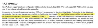

If you don't need ECC, you can disable ECC to have  more SRAM used for ECC as regular SRAM, which will increase the available memory.
All SRAM blocks (except RAMA) ECC bits are located in .SRAMG and SRAMH.  But if you disable ECC, they free up for general use. see below extracted from RM:

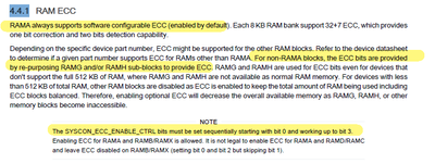

To do it, we need to configure SYSCON_ECC_ENABLE_CTRL register. Note that ECC is enabled by default for RAMB and RAMX on ECC-supported parts, but you can turn it off via this register.
Just make sure to follow the specified sequence when setting the register bits to avoid issues. see below I extracted from RM
For more, see MCXNx4xRM, chapter 4 Memory.
