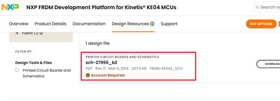

You can also check the circuit connections of your custom board by referring to the schematic of FRDM-KE04, focusing on the power supply and SWD sections.
FRDM-KE04Z|FRDM Development Platform|Kinetis® MCU | NXP Semiconductors

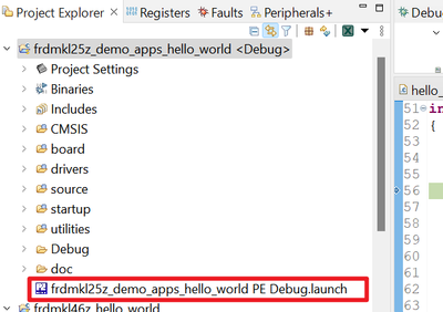

I’ve checked the connections and everything is in order; I’ve also cut the appropriate jumper. In fact, I’m now encountering a new issue. After attempting to program the MKE04Z8VWJ4, I reconnected the jumper to program the KL46Z’s own microcontroller, but I’m getting connection error messages from the MCUXpresso IDE. This is the first time I’ve experienced something like this. It’s strange because the OpenSDA interface is functioning correctly, and the PC properly recognizes the board. However, when I try to load a program onto the board, I get the error shown in the attached image.

Hello @fede_galassi ,
Could you help try to delete the .launch configuration file and try debugging again?
BRs,
