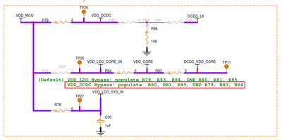

According to the comments in the FRDM-MCXN236 schematics, pins VDD_DCDC and DCDC_LX are pulled to GND through 10kR. But the therein mentioned suggestion is to disconnect VDD_CORE pins from the MCU supply, just keep the capacitors connected. But the datasheet shows that this pin is an input (-> requires an external power source for my understanding). However, somewhere else the datasheet mentions that the LDO_CORE pin is an output ("When the LDO_CORE is bypassed, the input VDD_LDO_CORE and output VOUT_CORE/VDD_CORE should be connected together...")
Which is correct? How should I connect the VOUT_CORE?
Furthermore, why should one byass the LDO_SYS by connecting (suggested option in FRDM schematic)?

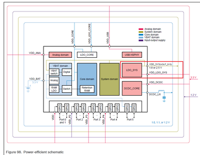

" Why should one byass the LDO_SYS by connecting (suggested option in FRDM schematic)?"
You can check the figure 98.
Power direction
VDD_LDO_SYS_IN -> LDO_SYS -> VDD_SYS(VOUT_SYS).
If you want to bypass LDO_SYS.
You can connect VDD_LDO_SYS_IN to VDD_SYS.

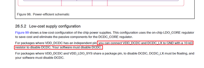

According to the MCX N23x Reference Manual.
For packages where VDD_DCDC has an independent pin, you can connect VDD_DCDC and DCDC_LX to GND with a 10-kΩ resistor to disable DCDC. Your software must disable DCDC.
And in the FRDM-MCXN236 schematic.

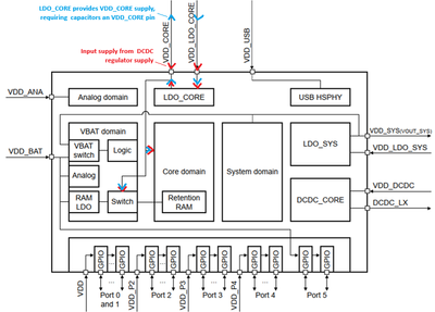

Basically I read this before in the FRDM schematics und the datasheet and the referene manual. Maybe now I have an idea:
1. VDD_LDO_CORE is an input (e.g. 3.3V).
2. If internal LDO_CORE regulator is used, it delivers VDD_CORE for internal core domain and this output is also routed on VDD_CORE pin (which makes it an output).
3. If DCDC is used,  the core domain will be supplied through VDD_CORE pin (which becomes now in input). Also VDD_LDO_CORE will be supplied by the DCDC voltage to avoid the pin floating.
Does it make sense?

Hi @Weber1
About 1 2 3, I think you are right.
