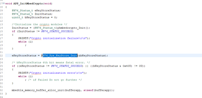

pberveiller
Hello, thank you for you reply.
I just want to run the example from the PN7642 SDK.
In second time, I will use the keystore .
I share you the init function.

jimmychan
Please try the key store first.  If you want to use cryptographic operations with the key store you have to initialize it first. Please have a look at PN76_Sys_KeyStore_Init in our mbedTls demo application.
