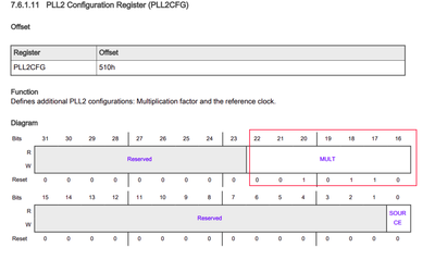

For i.MX8ULP, the current BSP doesn't provide tool to change the cpu frequency, if we need to change the frequency, we can modify register value by using /unit-tests/memtool.
According to RM, from Chapter Clocking, we can know PLL2 is used exclusively for the A35, and in Chapter Clock Generation and Control(CGC1), there is a group of PLL2 registers, among them,
there is a division unit and a multiplication unit:
Overall, we can follow such steps to change the A core frequency:
  1. Switch a35 to another reference clock
  2. Modify PLLEN to 0
  3. Modify multiplication and division factors
  4. Modify PLLEN to 1
  5. Switch 35 back to PLL2
# Switch a35 to FRO 192 MHz
/unit_tests/memtool -32 0x292c0014=0x08000000
# Set PLLEN to 0
/unit_tests/memtool -32 0x292c0500=0x03000000
# Read and set the division and multiplication factors
/unit_tests/memtool -32 0x292c0014 1
/unit_tests/memtool -32 0x292c0510 1
# Set PLLEN to 1"
/unit_tests/memtool -32 0x292c0500=0x03000001
# Switch a35 to PLL2"
/unit_tests/memtool -32 0x292c0014=0x18000000
mhz
