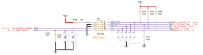

Hi NXP,
We reserve the JTAG pins for potential JTAG functionality on the device.
Although we will primarily use SWD for development and debugging, we still need to know how to configure the device to support full JTAG functionality if needed.
Here are the steps from google to support the JTAG on MCXN547.
Please correct me if there is anything wrong or provide the related document. That would be great.
By default, the MCU is set to SWD mode. To enable JTAG, we need to configure the BOOT_CFG fuses—either directly or via the ISP tool (blhost).

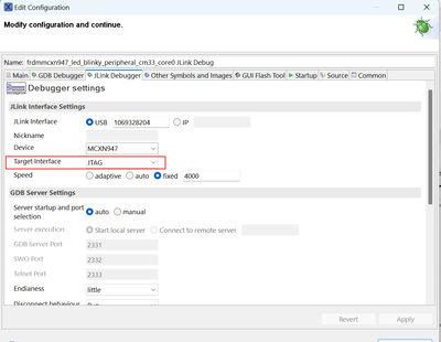

Hello @Sparklin
Thanks for your question.
Both SWD and JTAG are enabled on the MCXN547, so there's no need for software configuration. For SWD/JTAG hardware design, please refer to the schematic of the FRDM - MCXN947.
https://www.nxp.com/webapp/Download?colCode=90818-MCXN947SH
If you using MCUXpresso with J-link probe,  choose JTAT as below:
If you have any issues or concerns, don't hesitate to contact me.
