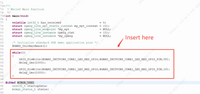

       I need to control GPIO or other interface in MCXN947 slave core (or CPU1, not CPU0).
       Based on example <multicore_examples\rpmsg_lite_pingpong> in v25.06 FRDM-MCXN947 sdk, then take a P0_10(RED_LED)configuration and create control code to salve core main function. After built, I find that RED_LED can't be controlled.
        Hope you can help me find the reason and fix it.
        Thanks very much.
----Test code
1>for RED_LED pin configuration, I used MCUXPresso IDE to config and generate code automatically.
   shown as below.
2>for RED_LED control, below is the code I  create in slave core project.

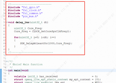

#include "fsl_gpio.h"
#include "fsl_clock.h"
#include "fsl_common.h"
#include "pin_mux.h"
void delay_1ms(uint32_t dt)
uint32_t Core_Freq;
Core_Freq = CLOCK_GetCoreSysClkFreq();
for(uint32_t i=0; i<dt; i++)
SDK_DelayAtLeastUs(1000,Core_Freq);
while(1)
GPIO_PinWrite(BOARD_INITPINS_CORE1_LED_RED_GPIO,BOARD_INITPINS_CORE1_LED_RED_GPIO_PIN,0U);
delay_1ms(1000);
GPIO_PinWrite(BOARD_INITPINS_CORE1_LED_RED_GPIO,BOARD_INITPINS_CORE1_LED_RED_GPIO_PIN,1U);
delay_1ms(1000);
 BTW, I have tested that the code shown above can work in single example, as <demo_apps\hello_world\cm33_core0>

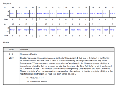

Hi, jimmyli
Please configure the register `PCNS` in GPIO peripheral. This register controls if the corresponding pin‘s registers can be modified in Secure/NonSecure state.
The Core1 in MCXN947 does not implement SAU(Security Attribute Unit), which means that the Core1 is always in NonSecure state, so register read/write to corresponding pin's registers under Core1 has no effect.
Logiase Song

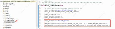

jimmyli
Hi Logiase,
     Thanks very much for your replying.
     Yes, I have found that before booting core1, it needs to config the referent pin to non secure state and can be controlled by core1 , and the pin can be controlled by core1.
  ----below code is added to initHardware() in core0 project
CLOCK_EnableClock(kCLOCK_Gpio0);
GPIO_EnablePinControlNonSecure(BOARD_LED_RED_GPIO, (1 << BOARD_LED_RED_GPIO_PIN));
