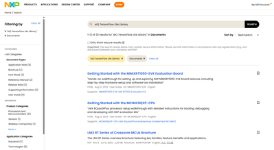

@carlos_o I searched on the official website of NXP, there are no document as you described thus far. But can you further elaborate on "HW optimized operators"? What does that mean exactly? So are these the only operator that can run on the eIQ NPU and all other operators have to fallback to the M33 with cmsis-nn?

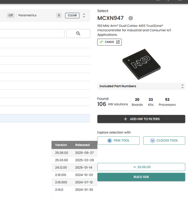

@carlos_o Hi, I just downloaded another new SDK of MCXN947 with all available middleware from the SDK builder. I don't have such User's Guide. Can you make sure that is a publicly available document?
1,319件の閲覧回数
carlos_o
Hi @TomC818
Could you share which version of the SDK are you downloading? And the content of the folder where you unzip the sdk?

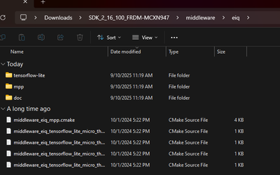

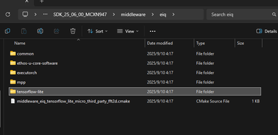

@carlos_o I downloaded the latest version. There are no doc folder in eIQ. Can you confirm that the user guide is packaged with the sdk?
1,251件の閲覧回数
carlos_o
Hi @TomC818
I review that the documentation I mentioned is only included in the FRDM-MCXN947 SDK, apologies for the inconvenience. Could you please download it and confirm that you can see the docs folder at eiq middleware?
About your question of HW optimized TFLM opertaros, you are in the correct the operators on that list are the one that can be run on the eIQ NPU, the other operators are executed at the Cortex-M33 with cmsis-nn.
