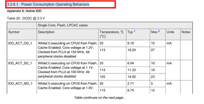

Without considering the peripheral devices related to the MCU, what is the maximum current consumption of the MCU under maximum operating conditions?
I couldn't find this data in the relevant technical documents. Did I miss it?

Hello @WillieWu ,
About this data, please refer to the section "3.2.6.1 Power Consumption Operating Behaviors' of data sheet.
Tables 20 - 25 list in detail the currents under different conditions for different power supplies.

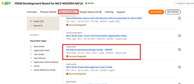

100 mA cannot be used as the maximum current value for designing the MCU power supply. The maximum current should exceed 100 mA, and a margin should be reserved for the power supply.
For more suggestions regarding the power supply, you can refer to the hardware design guide UG10092.
