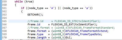

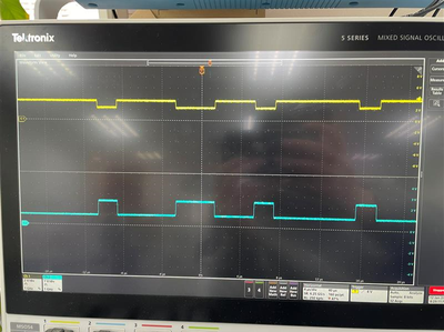

I'm using the FRDM-MCXN947 canbus loop back example as a starting point for sending and receiving canbus data.
However, when I disable loopback and mix the pins, the mcu still doesn't seem to be connected to the canbus pins.
Data output doesn't get detected on the oscilloscope.
Is there something else that I'm missing g for the loopback example to be able to communicate with other can nodes?

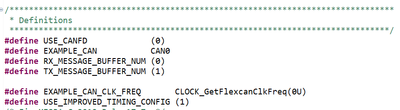

Hi @stevenlutz
I changed the interrupt demo.
I switched the extended can and disable can FD.
Harry_Zhang_0-1736739532787.pngHarry_Zhang_1-1736739621014.pngHarry_Zhang_2-1736739637820.pngHarry_Zhang_3-1736739882080.png
You can see that there is data transmission on the CAN bus.
Harry

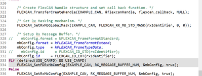

stevenlutz
I did the same thing, but there was a bit of code earlier in the demo that I didn't understand.
After lookingat the datasheet for the can Tranciever I saw that the initialization function needed to stay in.

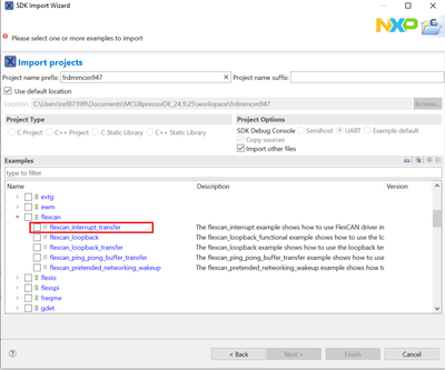

Harry_Zhang
Hi @stevenlutz
If you want to communicate with other CAN nodes using FRDM-MCXN947 board,
You can refer to flexcan interrupt demo.
Hope this will help you.
