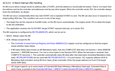

I met a few issues about I3C receive IBI payload issue. Hope you can help. Appreciate.
When I used NXP974 as I3C master, how many payload data include MDB can we received? In my test, it seems the maximum is 8 bytes. (one MDB and seven payload data). But from the spec, it indicates that support 9 bytes include MDB. Can you help to confirm?
Spec : The controller automatically stops IBI data after 9 bytes (including the mandatory data byte).
Another issue I met is when I set the payload to 8 bytes, I do received the 8 bytes from fifo but it will enter IBI again and caused system stuck even if we didn't send new IBI from i3c target. When the payload size is less than 8 bytes, it works well.
I checked the RX FIFO count from SDATACTRL, it is 8. I think it is correct. And the status of irq seems correct, it is same as normal case (0x2e00). So I guess it is correct too.
Then, I tried to capture the waveform by LA. I found some different between correct and incorrect case.
In normal case (payload < 7) the whole clock period of last T-bit is low, then generate a Stop.
In the wrong case, the SDA will be high in the rising edge of the T-bit clock. Then, resend clock (open-drain).
Do you know what happened on the NXP? Why there are different behaviors when the payload size is different?

Hi Jackie!
We have also faced this problem in the past and reported it to NXP. We got the confirmation that this is a bug in the NXP I3C IP block. The IBI Payload Length cannot be greater than 8 bytes, and additionally, the I3C Target SHALL use the T-Bit to indicate the End Of Data (T-Bit LOW) in the last byte. The I3C IP Block, when acting as the controller, cannot emit the STOP condition if the T-Bit is HIGH.
1,800 Views
Harry_Zhang
Hi @JackieZhu
Yes, you are right. I3C target supports up to seven bytes of Extended IBI Data following a Mandatory Data byte.
So  include MDB, the maximum is 8 bytes. (one MDB and seven payload data).
