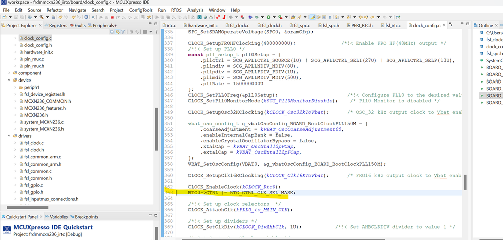

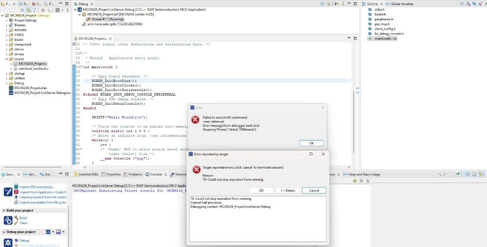

Dear Team,
I'm working with FRDM-MCXN236, I tried to demo RTC with irtc example code but got issue while i config to use external 32.768Khz OSC,
The issue as picture, please help to advise solve solutions.

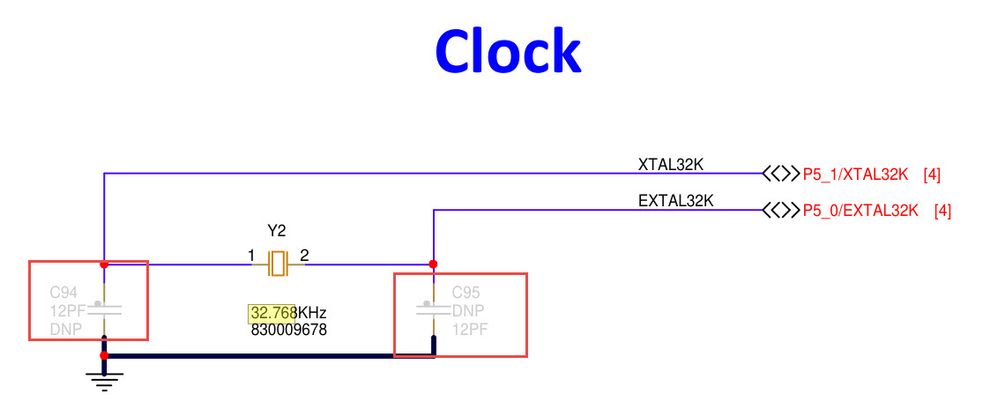

LocNguyen31
Hi Alice Yang,
no Capacitor for this circuit, but i have measure the signal for this Crystal, the signal wave form is good, so Can we can ignore the hardware issue?
thanks.

Hello @LocNguyen31
Please debug step by step to check which code causes the crash.
If a crash occurs during download, please create a new MCUXPresso IDE workspace and a new project. Pay attention to choosing the right chip. Then, configure the CLOCK, build the project, and start debugging.
Alice

LocNguyen31
Hi Alice,
Still bug at line 363 in file clock_config.c, i'm trrying to study this register,  I still don't understand why there is a bug at this command line
RTC0->CTRL |= RTC_CTRL_CLK_SEL_MASK;

kingchen2019
note: below update.
/* Enable fro16k[0] to domain Vbat and Main */
// CLOCK_SetupClk16KClocking(kCLOCK_Clk16KToVbat | kCLOCK_Clk16KToMain);
CLOCK_SetupOsc32KClocking(kCLOCK_Osc32kToVbat | kCLOCK_Osc32kToMain);

Hello @LocNguyen31
Please connect  capacitors to EXTAL32K. The external passive crystal oscillator must be connected to  capacitor.
Alice

Hello @LocNguyen31
Please double - check whether there are capacitors connected to EXTAL32K.
Alice
