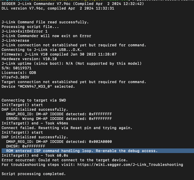

I'm working in a project for the MCXN947 microcontroller in a custom PCB.
Debugging was working fine in the beggining using a J-link in SWD mode.
Then the session was interrupted and when I try to restart or full erase it, a timeout occurrs.  Seems like the uC is stuck in ISP mode or something like that

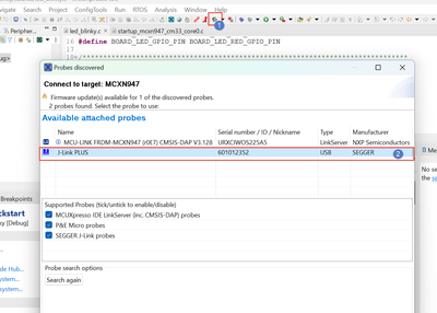

I tried with another Jlink, but same issue happens

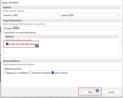

You can use the MCUxpresso IDE to try erasing Flash and downloading programs to the chip.

I tried many times your propossal, but it didn't worked. Everytime I try, the same message appears: "ROM entered ISP command handling loop. Re-enable the debug access".
I tried to erase it directly in command line, but same issue happens:
Is there another way to recover this uC?
