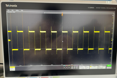

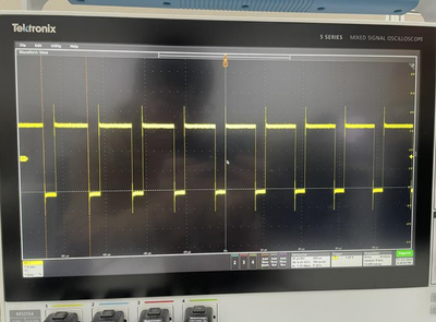

I successfully run the SDK sctimer_pwm_with_dutycycle_change example program on the MCX-N5XX-EVK board. I successfully changed the PWM mode from Center-Aligned to Edge-Aligned.
But I get the following issues:
  1. The SCT outputs a short high impulse when I set 0% duty cycle.
  2. The SCT outputs a short low impulse when I set 100% duty cycle.
