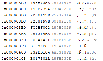

I'm developing for FRDM-MCXC444 with bootloader.
I'd like to use I2C peripherals to update MCU flash memory in bootloader.
So I wrote some commands to erase and write flash memory.
However, there're some troubles after writing flash memory via I2C.
The MCU stuck at "HardFault_Handler" when I try to use debug with MCUXpresso IDE.
I use debug to read back the memory as follows.
You can see some wrong data in the corresponding configuration location.
I know this is cased by writing wrong data to flash memory.
But I can't erase the flash or do anything to recovery it.

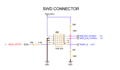

In addition, you mentioned "can't erase the flash or do anything to recovery it." Does this mean you can't erase it even with an external debugger? Have you tried connecting J10 with JLINK/MULTILink for mass erase?
