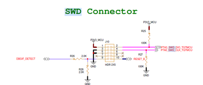

  1. Hardware design: Is your board a custom board? If yes, please check the hardware design part for SWD. Refer to the schematic of the FRDM-MCXC242 for guidance:

I am working with a custom board that includes only the microcontroller, an SWD connector, and the necessary resistors and capacitors. This setup was designed primarily for testing purposes, as I plan to use the MCXC242VFM in my project (which has a different package than the FRDM-MCXC242).
When I attempt to program the microcontroller, I receive the message: "0 available SWD devices detected." I believe the system detects the presence of a microcontroller but is unable to identify the part number. I have attached a screenshot for reference.
I double-checked the SWD connections and compared them to the FRDM-MCXC242 board (which I also have). According to the MCXC242 datasheet, it suggests using a 10k pull-up resistor on SWD_DIO and a 10k pull-down resistor on SWD_CLK. However, on the FRDM-MCXC242, I noticed that 100k resistors are used instead.

Please send the schematic of your board. I help you check. Thanks.

I’ve attached the schematic of my board for you to take a look at. Let me know if you need anything else!

I have reviewed your attachment. It appears that there is no issue with the SWD design. You might try changing the 10k resistor to a 100k resistor, as shown in the schematic of the FRDM-MCXC242. If it still doesn't work, please try using a different debugger and USB cable for testing.

I tried using the 100k resistors, but it still didn’t work.
