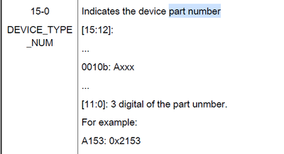

    还有一个问题,程序有办法识别芯片型号吗?我想通过返回值区分MCXA133和MCXA132,有相关的寄存器吗?
Thank you very much for your reply. I checked the user manual Chapter 45: Memory Block Checker (MBC), which should be able to achieve the function I want, but I did not find the SystemInit() function in the flashiap demo of MCXA153. In which demo did you see the MBC related operations?
Another question, is there a way for the program to identify the chip type? I want to distinguish MCXA133 and MCXA132 by the return value. Are there any related registers?

For the second question, you can read the register DEVICE_TYPE.
