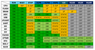

Yes, you can refer to this picture.
RUN WAIT STOP VLPR VLPW VLPS LLS
In these low-power modes, it is possible to wake up without losing data.

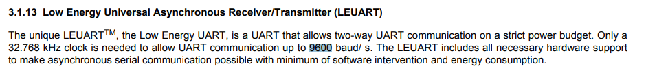

But based on our past experience, 32.768KHz is not enough to run 9600 baud rate, unless the IC itself is specially designed for this. Usually if it is, it will be written in the file.
For example in silicon lab efm32zg datasheet:
Or for Nuvoton M480:   https://www.wpgdadatong.com/blog/detail/40814
So we wanted to confirm if mcxc142 can actually do this.
