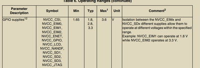

Hi Team,
Below i have mentioned net names. how much current is required for each net? Please share the details. It is not mentioned any documents i have verified. please help me.
NVCC_EIM3.3VD
NVCC_GPIO3.3VD
NVCC_LCD3.3VD
NVCC_JTAG3.3VD
NVCC_ENET2.5VD
NVCC_RGMII2.5VD
NVCC_MIPI2.5VD
NVCC_LVDS2.5VD
Thank you.

i.MX 6Quad and 6Dual chips can support three
different EIM power rail voltage levels:
NVCC_EIM0(K19),
NVCC_EIM1(L19),
NVCC_EIM2(M19).
Is these pins are input or Output. If input means What is the voltage and current requirements?
This is what i am asking for previous message mentioned signals as well..

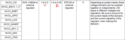

You can get the value from the below link HDG file.
https://www.nxp.com/webapp/Download?colCode=IMX6DQ6SDLHDG
B.R
2,472 次查看
RamakrishnaC
Thank you.
In this document showing Supply regulator current capability group of nets. already verified this document. Could please share the individual maximum requirement current details?
