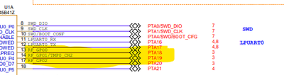

I have KW45 EVK board as well as I have KW45 LOC board I was using kw45 EVK sdk for both when I flashed eatt central code in kw45 LOC board and from evk sdk code was working but1 I want to confirm from NXP as EVK board only have one inbuilt antenna how code design for evk is working in LOC board as how to switch antenna for EVK from internal to external NXP can confirm is it be down by software or hardware changes
2 In LOC board USED EATT CENTRAL CODE want to use J7 and connect external antenna and I added one function BOARD InitRFSwitchControlPins in eatt central and changed the antenna from A to J7 in software but without connecting external antenna I am receiving data from BLUETOOTH how it is possible please see the image for reference
Can NXP confirm both the point mentioned above, and like only software or hardware software both changes are required in both EVK or LOC board

Hello Chetan, Sorry for the late response
The pin configuration is right for using RF1 mode, Only the changes made in BOARD_InitRFSwitchControlPins [ pin_mux.c] are required.
Receiving data over BLE it’s the expected behavior. I test the configuration made in w_uart example.

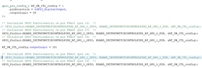

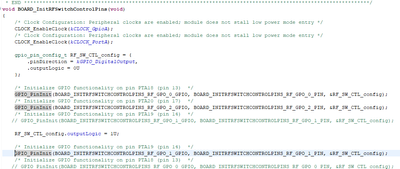

chetan98
I am using LOC evk example, and I am considering for antenna switch only changes are required in the part which I am mentioning below can you please confirm?
because in document just switch information is given and need to change what is configuration of the pin required.
I did following changes in pinmux.c can you please confirm it is correct for J7 and only changes are required in pinmux.c
I want to use J7, after doing this configuration mentioned in the document for J7 without  connecting external antenna I was receiving data over BLE in LOC board, is it predictable behaviour?
I did following changes in Pinmux.c can you please check only changes are required in this part only for using external antenna.

luis_maravilla

chetan98
okay Luis but without using external antenna when internal antenna is off ,how it is possible I am receiving data can you explain.
4,228件の閲覧回数
luis_maravilla
Hello Chetan,
For receiving data without an antenna; The exposed U.FL pad and PCB traces can unintentionally act as a weak antenna; also, BLE receivers are very sensitive, while is not the intended use for the configuration using it without an antenna, it can receive data in short range reception.
