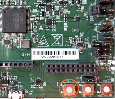

Dear Team,
We have prepared our custom board with KW45 MCU.
We do not have pins required for ISP
In my Dev board "KW45 EVK" the MCU comes pre fused with the Default keys.
I am using custom board designed  by us, I want to know following -
1. I don't want to use security features, can I RF Core run without it ? Without using Fuse ? My application is simple and do not require security.
2. I read somewhere that MCU KW45 comes with default "NULL" keys from plant. Can I use 0x00 "NULL" keys and flash my NBU ? Will it work ?
3. If above 2 question - No. Can you tell me how can I use default keys of KW45 EVK board and program the fuse so that I can use the same keys ?

The ISP pin is recommended for updating authenticated and optionally encrypted firmware via SB3 files, as the KW45 requires signed firmware to be loaded into the NBU through the bootloader. I would recommend adding this support if the board doesn’t have it. I understand giving ISP is necessary and considering future we can plan to give it, but in current proto we do not have it. We can try to do some custom rework just to get the pin out from MCU.
You can consult how is this pin connected in the KW45EVK Board with the KW45B41Z Evaluation Kit Board Schematics and you can refer for more information about this on this Community post The best way to build a PCB first time right with KW45 (Automotive) or K32W1/MCXW71 (IoT/Industrial)..., and in KW45 Hardware Design Recommendations Presentation in Bootloader pins slide.
We have considered the First time right document and designed the PCB and Schematics
On the other hand,Application Note AN14003describes the process for programming the KW45 fuse, burning CM33 and NBU firmware operations. Also how to implement a merging of the NBU image and CM33 flash via SWD for mass production is addressed in this document.
We have followed the process as per AN14003 document strictly but the end result was - We were getting Warning at the end of flashing "No Data written in Flash" while the flashing process succeeded. Note that we do not have ISP and we are flashing using SWD and FX Multilink Debugger. Flashing of firmware in CM33 is not a problem, but we are not sure if the fuse was programmed and NBU is flashed as RF did not work at all. Additionally I also see that on my custom board the .bin files are unable to flash once I convert axf to bin. I don't know if it relates to anything form above.
