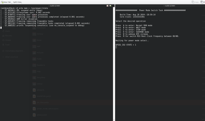

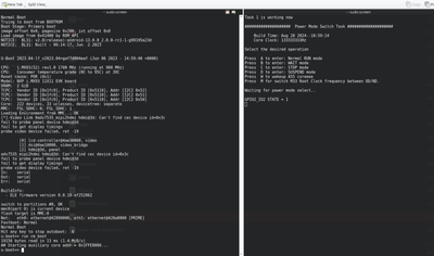

I made some modifications to the power_mode_switch example of the SDK_2_16_000_MCIMX93-EVK, please see the attached patches.
I used the GPIO_IO2 to get an IRQ and wake up the A55 Core:
(Left side Cortex - A55 and Right side Cortex - M33)
I booted the Cortex M33 on Uboot, then boot linux and sleep it:

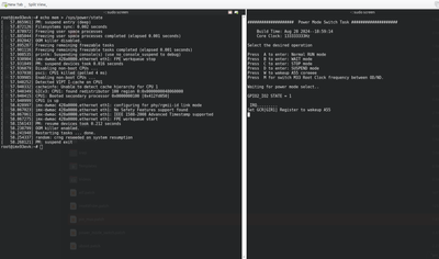

Finally, I have a button connected to GPIO_IO2, and when pressend Linux will wake up:
Please let me know if it worked for you. I am using SDK_2_16_000_MCIMX93-EVK and Linux imx93evk 6.1.22.
