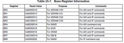

Generally, the FPGAs are connected as SRAM devices but it will be limited to your specific SRAM.
Regarding your connections, they should be made as table 25-6 from the RM states. Some signals will be shared between SDRAM and SRAM.
Each device will have a specific base register, where you can configure base address, memory size, and valid information.
