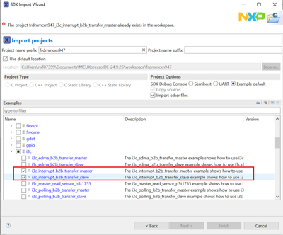

Harry_Zhang
Hi @yvan_yan

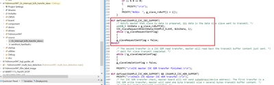

You can refer to the i3c_interrupt_b2b_transfer demo.
Master:
Slave:
Harry

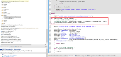

yvan_yan
Hi @Harry_Zhang
We refer to i3c_interrupt_b2b_transfer_master, slave use our own device.
ibiHasPayload is already true, but payload still recognized as ibi address.
Could you show me the correct wave form?

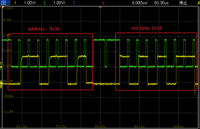

yvan_yan
Hi @Harry_Zhang
Our waveform is as follows, md byte is address clock.
I notice MIBIRULES register is 0x40000036, seems correct.
Is there anything else I should be aware of?

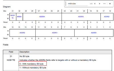

Harry_Zhang
Hi @yvan_yan
"I notice MIBIRULES register is 0x40000036, seems correct."
I have reviewed the definition of the MIBIRULES register.
If you want to ibi with payload. this bit should be set to 0.
But your 0x40000036 register is set to 1.

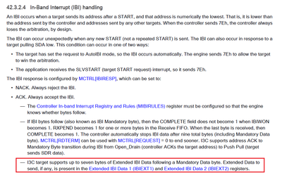

Harry_Zhang
Hi @yvan_yan
I3C target supports up to seven bytes of Extended IBI Data following a Mandatory Data byte.

Harry_Zhang
Hi @yvan_yan
About the IBI Payload, there are only two register (Extended IBI Data 1 (IBIEXT1) and Extended IBI Data 2 (IBIEXT2) registers.) to store the Payload Byte, not fifo.
I am referring to LPC553x Reference Manual.
You can  refer to the Chapter 42.

Hi @Harry_Zhang
The definition of the MIBIRULES register is from bit0 to bit31.
Bit31 of 0x40000036 is 0. If it sets to 1, the value seems 0xc0000036.
