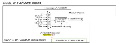

Alex_Wang
Hi, @CarlLee
You're missing something, and you also need to change the macro definition clock rate. As follows:
#define LPI2C_MASTER_CLOCK_FREQUENCY CLOCK_GetLPFlexCommClkFreq(9u)
Clock selection is as follows:
Hope this helps you.
Best regards, Alex

CarlLee
Dear @Alex_Wang  and @Alice_Yang,
Thanks for your help!
The solution is work properly.
I will add the i2c code to the face detection demo.
