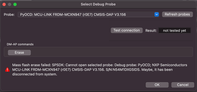

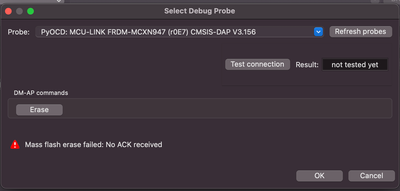

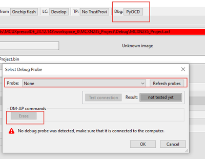

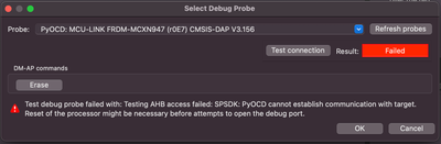

When in ISP mode, the debug probe can’t be found. Erasing from SWT also fails, being unable to connect to target. I’ve attached screenshots of the various errors I’m receiving using SWT below.
- Josh
Probe not found when in ISP mode:
Test connection error:
Erase errors:
erase_error1.pngerase_error2.pngerase_error3.png.

Hello @j0sh
I have already replied to your private ticket:
Thank you for your reply.
  1. What project did you download previously?
  2. When using SPT for mass erasing, it does not operate in ISP mode. Instead, it uses SWD, so there is no need to enter ISP mode. Just connect MCU-LINK(J17) with PC.
  3. Please take a photo of your hardware.
  4. Please try to check whether your board can be connected in ISP mode. The steps are as follows:
Press the ISP button, then power on your board using HS-USB (J1), and release the ISP button. Next, open SPT and follow the steps demonstrated in the video attached. Check whether a connection can be established. If not, I think the chip is broken.
