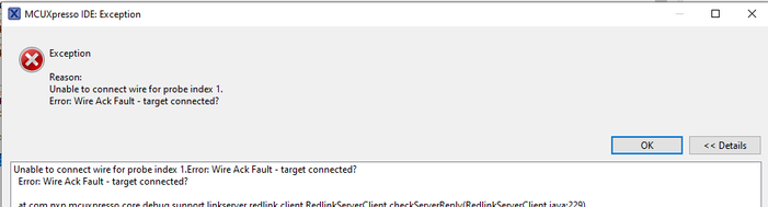

In my engineering school we give labs to a very large number of students using more than 100  FRDM-MCXN947 board.
1) Our students successfully compiled download and run there first programs (RGB led blink, switch etc) during the first lab.

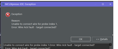

2) During the second lab some of them can't connect anymore to the on-board cpu to download and debug (I suspect that they have updated the firmware, as explained hereunder).

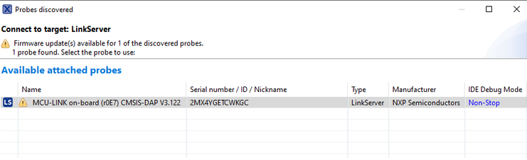

Here are the snapshots when entering the debug mode :
3) I disconnect the student board and connect my fresh new board with success !
(Since our labs, are installed with MCUXpresso IDE v11.9.1, I tried with the latest MCUXpresso without success connecting there boards again.)

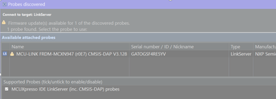

My board (working) :
4) From 3) I see a difference between the probe firmware versions :
  • my working board use a MCU-LINK CMSIS-DAP_V3_128
  • the problematic board use a MCU-LINK CMSIS-DAP_V3_153
I tried to reverse the firmware to V3.128 but can't find it on your website.
On NxP site, I only found MCU-LINK_installer_3.140 which allows me to reverse the board to V3_140 but the problem is still the same
Do you know where I can find MCU-LINK_installer_3.128 ?
Is is normal that upgrading the firmware cause such issue ?
Do you have other ideas ?
Thank you for your help !
Thierry

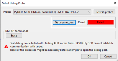

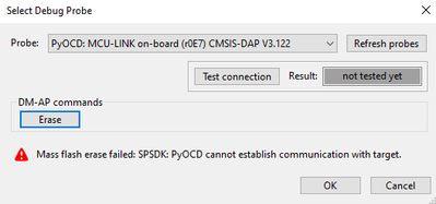

Unfortunlatly, the first step failed : SPT Erase give me this error message :
Then I clic "Erase" :

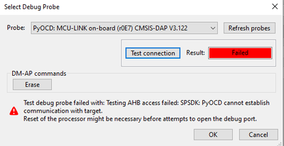

Clicking on "Test connection" return :
Is there a way to reset the processor to attempts to open the debug port ?
Thank you for your help,
Thierry

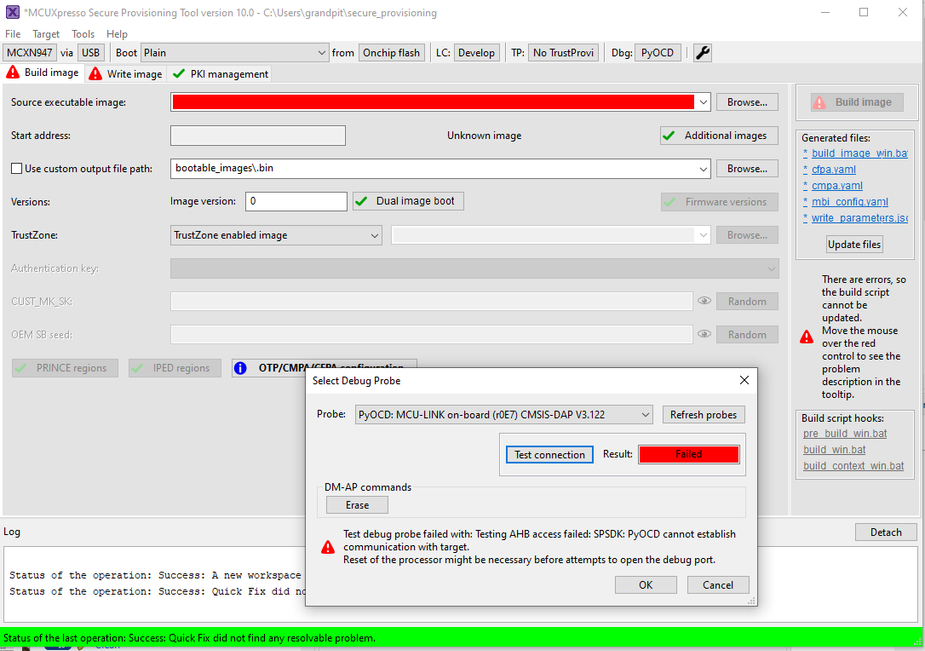

PS : the complete screen capture hereunder in case it may helps :

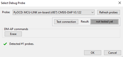

Thank you Alice for your answer.
1) Unfortunatly, reversing successfully (hereunder)  the version to 3.122  didn't resolve the issue.
2) I still get this message when entering download mode  :

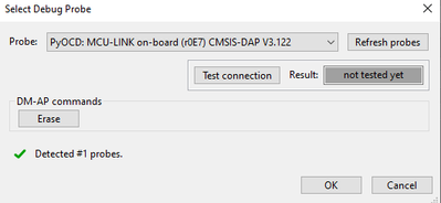

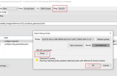

Hello @tgrandpi
Please test according to the following steps:
  1. Use SPT Erase.
2. Create a new workspace in MCUXpresso IDE.
3. Import a new simple demo.
4. Build and download the program for testing.
If it still doesn't work, please download and install the latest version of MCUXpresso IDE.
Alice

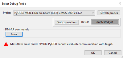

Unfortunatly, the first step : STP Erase failed :
When I "test connection", I get :
Can you tell me please a way to reset the processor as suggested by the error message ? Is it possible without specific external hardware ?
Thank you,
Thierry

tgrandpi
Dear Alice_Yang,
I finally succeed to recover our boards access with MUC-LINK :
I clicked several time STP ERASE button, spamming simultaneously the SW1/Reset button of the FRDM-MCXN947 board  (to reset the processor) !
Many thanks for your help !
(This worked with any version of MCU-LINK CMSIS-DAP which was finally not the point)
The subject is closed/resolved
