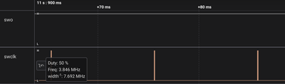

I'm trying to enable SWO on my MCXN947, but am having trouble getting it to output anything.

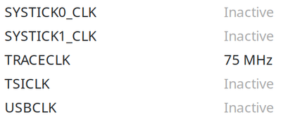

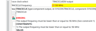

  2. I have TRACE_CLK enabled, and set to half the speed of the main clock, because MCUxpresso does not let me set a TRACE_CLK speed above 96MHz .

After all this, I see no output on SWO. It is simply held high by my SEGGER J-Link.

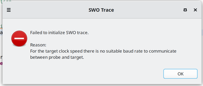

To try and follow the posted guide, I've been trying to use SWO Trace Config to configure my SWO, instead of the DebugConsole_Init.
  1. Load the frdmmcxn947_led_blinky_cm33_core0 example into the MXUxpresso IDE.
  2. Mux SWO
  3. My use case requires a 150MHz clock. Enable 150MHz clock by changing 'Initalize USBPHY clock' to 'PLL only'. Change BOARD_InitHardware(...) hardware_init.c to call BOARD_BootClockPLL150M(...) instead of BOARD_BootClockFRO12M(...), and update SysTick_Config(...) from to 12000000 to 150000000.
  4. Set TRACECLK to 75 Mhz (because 96MHz is max).
  5. Click Update Code.
  6. Click Debug.
  7. Click Resume All Debug sessions.
  8. Open SWO Trace Config.
  9. Click Change to configure main and trace clock speed.
  10. Get an error. Are certain baud rates expected?
If you can, let me know if this issue reproduces on your side.

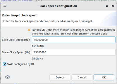

Now, SWO trace config can find my board, at a clock speed of 150MHz, and a trace clock speed of 75MHz. I'm really happy MCUxpresso can find it now!
However, I did notice that after SWO Trace Config connected, the blinky on my board stopped running, and connection may not be complete. In screenshots from the MCUXpresso IDE Linkserver SWO Trace Guide, all dots on the right were green, for example, probe backend. Did you see this on your side?
