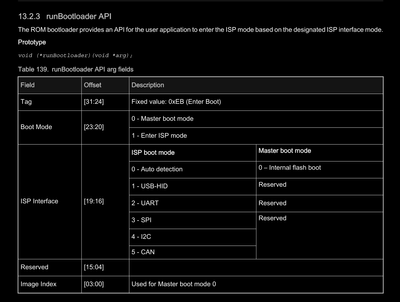

If you do not want to use the ISP pin, you can consider using the runBootloader API to enter ISP mode based on the designated ISP interface mode.
If you also do not want to use blhost and prefer to write your own script, I'm sorry,  I don't know how to use Python scripts for this purpose. But you can refer to the "14 In-System Programming" section of the Reference Manual (RM) for development.
