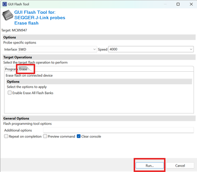

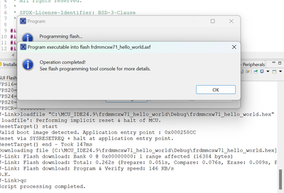

Hello @trulykk ,
Thanks for your support. The J-Link does support the MCXW71. I did the test with the SDK demo.  Please see the figure below.
I've pasted the log below for your comparison.

J-Link>loadfile "C:\MCU_IDE24.9\frdmmcxw71_hello_world\Debug\frdmmcxw71_hello_world.hex"
'loadfile': Performing implicit reset & halt of MCU.
ResetTarget() start
Valid boot image detected. Application entry point : 0x000258CC
Reset via SYSRESETREQ + halt at application entry point.
ResetTarget() end - Took 147ms
Downloading file [C:\MCU_IDE24.9\frdmmcxw71_hello_world\Debug\frdmmcxw71_hello_world.hex]...
J-Link: Flash download: Bank 0 @ 0x00000000: 1 range affected (16384 bytes)
J-Link: Flash download: Total: 0.262s (Prepare: 0.051s, Compare: 0.076s, Erase: 0.009s, Program & Verify: 0.109s, Restore: 0.016s)
J-Link: Flash download: Program & Verify speed: 146 KB/s
O.K.
J-Link>qc
Script processing completed.
Based on the log, it's a connection issue. I suggest you try the following methods:
1. First, check whether the connections are loose.
2. Perform a mass erase and then try again.
3. Use the J-Link on other development boards to see if the problem still occurs.
Hope it can help you.
