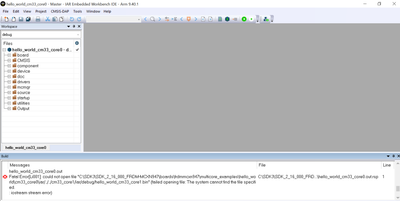

I can use IAR 9.50, 9.40 build core1 project, but can not build core0 project, I always got following error:
Error[Li005]: no definition for "_hello_world_cm33_core1_image" [referenced from <internal module>]

I tested with 9.30.1, 9.40.2,9.50.2, all of them can not build core0 project.
9.30.1 can not open ewp file, it said it's too old.
9.40 & 9.50 can open ewp file, but can not build core0 project.
I downloaded code from:
https://mcuxpresso.nxp.com/en/example-projects?uvid=573500
Here is my screenshot:

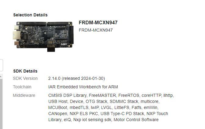

My SDK version, where I can download latest SDK_2_16_000_FRDM-MCXN947:

I downloaded SDK_2_16_000_FRDM-MCXN947.
I directly compile core0 project.
This is because you are missing core 1 Image, so you need compile core1 project.
And then you compile Project core0 project again, and it will succeed.

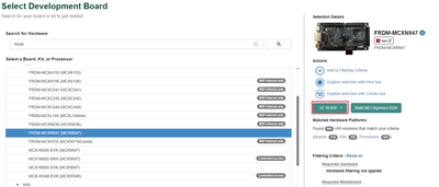

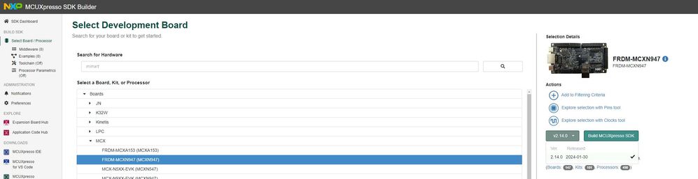

Where I can download 2.16 SDK? I can only see 2.14.0 in following page:

You can visit the official website
Select Board | MCUXpresso SDK Builder (nxp.com)
Hope this will help you.

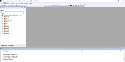

You should build core1 project first, and then build core0 project.

max_meng
Yes, I do the same process as you said, core 1 project can build, core 0 project always fails.
