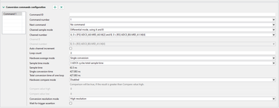

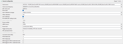

I want to use the 16bit differential ADC on the FRDM MCXN947 dev board. I cannot get the configuration correct. See the screenshots attached to see the configuration in Config Tools. My main code is added as code sample, could someone help me figure out why I cannot get a result from the ADC.

Hello @Dirk3
Please check below settings.
1> Use oscilloscope confirm there is input signal in ADC channel of your board.
2>Config ADC input pin correctly.
3>Enabled clock.
4>Using ADC demo under SDK to test firstly, whether can work without any issue?
Alice
