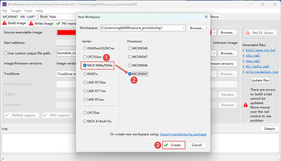

Step1. Create new workspace
After opening the software, click File->New Workspace, select "MCX N94x/N54x" -> MCXN947 -> Click "create". Refer to the following figure:

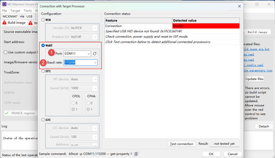

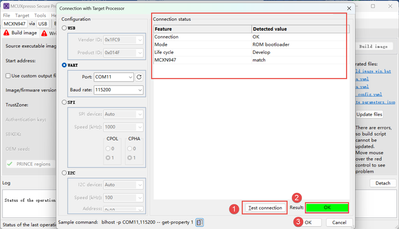

Enter ISP mode:Press and hold SW3(ISP key) => Press and release SW1 (RESET key) => Release SW3
Go to your workspace and click “Target”->Connection, the Connection with Target Processor window is displayed. Here, we make Connection through UART and select port and baud rate. Refer to the following figure:
We can click "Test connection" to check whether the connection is successful. If the connection is successful, the result will display "OK". Refer to the following figure:

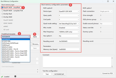

Here we use a simple configuration, click "FlexSPI NOR-simplified", on this Predefined template, select W25Q64JW and click apply. Then, corresponding parameters on W25Q64JW will be automatically created on Boot memory configuration parameters. Normally, keep the default value. Refer to the following figure:

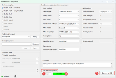

We use "Test the configuration" to check whether the configuration is correct. After clicking "Test", the script will pop up to run automatically, and "SUCCESS" will be displayed after running. Refer to the following figure:

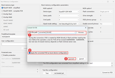

Then click "convert to FCB" and the "convert to FCB" dialog box will pop up. Keep the default position of "FCB file path". Select "Apply the converted FCB as boot device configuration" and click "convert". The script automatically runs and generates "converted_fcb.bin". The FlexSPI NOR-complete FCB window is displayed. Refer to the following figure:

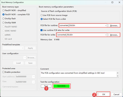

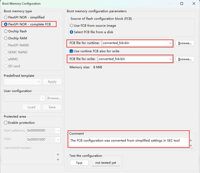

The generated converted_fcb.bin file is automatically loaded to FCB file for runtime and FCB File for write. Click "Test" and "SUCCESS" will be displayed. Click "OK" to close the window. Refer to the following figure:

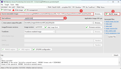

After completing the above operations, we need to load the .s19 or .hex file generated by MCUXpresso IDE into the Source executable image.
Note: The start address of the external flash of the project needs to be changed to 0x80001000. This section does not explain how to change the start address. For details, see “How to config booting from external flash”.
After the file is loaded, the start address is automatically identified. If the start address is not 0x80001000, you cannot "built image". Then click on "built image". Refer to the following figure:
After completing the built image, "SUCCECC: built image" will be displayed. Click "close". Refer to the following figure:

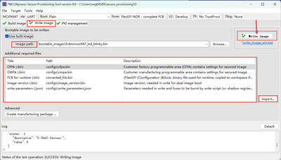

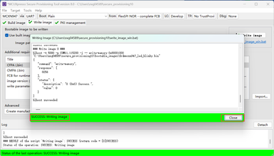

We can see that the required .bin file has been generated automatically in "write image", or we can import the corresponding .bin file we wrote by "import". The Image path file will be automatically loaded. Click "write image" to run the script automatically. After the file is successfully written, "SUCCESS: write image" is displayed. Refer to the following figure:
Finally, by pressing the RESET key on the board to exit ISP mode, we completed the configuration and downloaded the external flash image.
