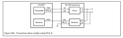

1. RS485 hardware connection
RS-485 is a multiple drop communication protocol in which the LPUART transceiver's driver is three-stated unless LPUART is driving. The transmitter can uses the RTS_B signal to enable the driver of a transceiver. The polarity of RTS_B can be configured by firmware to match with the polarity of the transceiver's driver enabling signal.
The following figure shows the receiver enabling signal asserted. This connection can also connect RTS_B to both DE and RE_B. The transceiver's receiver is disabled when the uart transmitter is sending char. A pullup can pull RXD to a non-floating value during this time. You can refine this option further by operating LPUART in Single-Wire mode, freeing the RXD pin for other uses.
When the uart transmits character via TXD pin, the RTS_b signal is asserted automatically, after the RS-485 transceiver, the urat transmitter can drive the differential signals Y/Z. When the uart dose not transmit character, the RTS_b signal is unasserted, so the RS-485 transceiver is in tr-state, the differential signal Y/Z is NOT driven by this RS-485 transceiver. For receiver part of the RS-485 transceiver, if the RTS_b sigbal is connected to the RE_b pin of receiver of RS-485 transceiver directly or via an inverter depending on the required logic of the RS-485 transceiver , when the uart transmits character, the receiver of  RS-485 transceiver is disabled, the RO pin of the RS485 is in tri-state, so a pull-up resistor is required on the RO pin and the RXD pin of LPUart can not receive any character from it’s own transmitter.
 The RTS_B signal can function as hardware flow control, but note the application uses RTS_b signal to control RS485 enabling instead of hardware flow control.

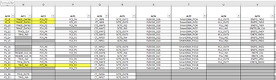

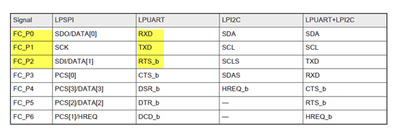

2. RTS_b pin assigmnet.
For the uart module of MCXN family, the FCx_P0 is RXD pin of UARTx module, the FCx_P1 is TXD pin of UARTx module, the FCx_P2 is RTS_b of UARTx module.
For MCXN94x family, the P1_8 pin can function as FC4_P0 or RXD pin of UART4; the P1_9 pin can function as FC4_P1 or TXD pin of UART4; the P1_22 pin can function as FC4_P2 or RTS_b pin of UART4 with setting up PORT1_PCR22[MUX] bits as decimal 3;

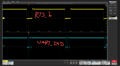

4)uart timing tested by scope
Conclusion:
From the above scope screen shot, you can see that when the uart transmitter sends char, the RTS_b signal becomes low, so it can function as RS485 transceiver enabling signal.
