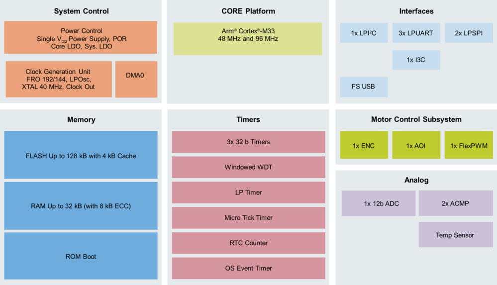

The following figure shows a top-level organization of the modules within the chip organized by functional category.
Figure 1. Features block diagram

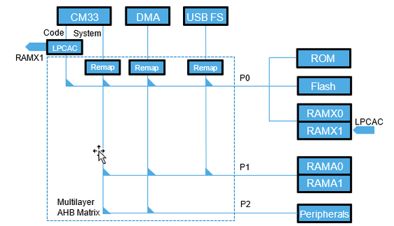

The following figure shows the Bus matrix block diagram of this chip. Where there are three bus initiators (CM33, DMA and USB FS) which to access to different slave ports thought a Multilayer AHB bus matrix. ROM, Flash and RAMX0/1 share the same slave port. RAMA0/1 share a second slave port. And the third slave port is used to access to the peripherals.
Figure 2. Bus matrix block diagram
The Bus matrix block diagram has de following features:
  • CM33
    • Max speed is 96MHz
    • Does not include MPU, FPU, DSP and Trustzone
  • Cache
    • 4KB LPCAC on CM33 code bus
    • 8-way, 2-set-associative design based on 256-byte superpages. The access to flash can be cached.
    • Write through
  • Flash
    • Up to 128KB flash.
    • Line buffer and prefetch buffer
    • IFR0 sector0 is CMPA region
    • Memory Block Checker (MBC) is used to control the access permission
    • Swap
  • RAM
    • SRAM is divided into Code TCM and System TCM:
      • CTCM: Mapped to CM33 code bus space
        • RAM X0: 8 KB 32-bit RAM
        • RAM X1: 4 KB 32-bit RAM
        • Can only be used as code RAM when LPCAC is disabled.
      • STCM: Mapped to CM33 system bus space:
        • RAM A0: 8 KB 32+7-bit ECC RAM
        • RAM A1: 16 KB 32bit RAM
        • Execute permission is configurable
  • Remap
    • When remap is enabled, the access to RAM X0, will be remapped to the end of system RAM

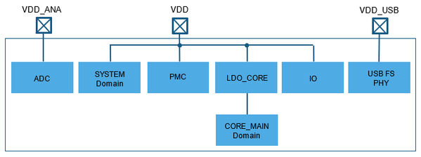

The following figure introduce in a simplified way the Power Architecture block diagram of the MCX A. Where it can be seen that consist in three power supplies (VDD, VDD_ANA and VDD_USB) to power system and peripherals.
Figure 3. Power Architecture
VDD is the main supply which powers SYSTEM Domain, PMC, LDO_CORE and IO. At the same time CORE_MAIN Domain is supplied by LDO_CORE. VDD_ANA supplies ADC. And VDD_USB supplies USB FS PHY.

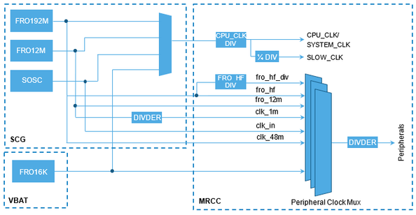

The following Figure shows a high level of Clock Architecture block diagram. In the left of the block diagram there are the on-chip clock sources, meanwhile in the right there is the distribution of the clock signals that clocking the systems and peripherals of the chip. The SCG controls FRO192M, FRO12M and SOSC clock sources. VBAT implements the 16 kHz internal clock source. And the MRCC provides on-chip modules their own dedicated MRCC bits for clock gating, reset control and configuration options.
Figure 5. Clock Architecture
The Clock Architecture has the following features:
Clock Source
  • FRO192M. Outputs 192/96/48MHz
  • FRO12M. Outputs 12MHz and 1MHz.
  • SOSC. Supports 8~50MHz
  • FRO16K. Output 16.384KHz
Clock Management
  • Overall clock architecture is same with MCXN
  • SCG and VBAT control clock generators
  • MRCC in SYSCON controls clock mux and clock divider of the system and peripherals.
