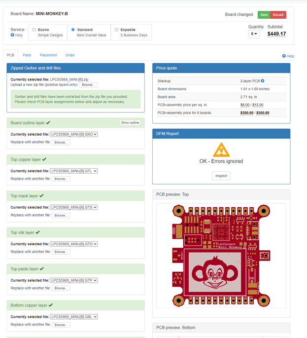

I had some design updates for “Rev B” of my Mini-Monkey design that I wanted to get in the "queue" for testing.  For the next revision, I wanted to try PCB:NG for the board fabrication and assembly.  PCB:NG is an “on-demand” PCB assembly service focused on turnkey prototypes via simple a web interface.    The pricing looked attractive and it appeared that the Mini-Monkey fit within their standard design rules.    The Mini-Monkey design uses an NXP LPC55S69 microcontroller that is in a 0.5mm pitch VFBGA98 package.   NXP offers guidance on how to use this device with low-cost design rules and I thought this would be a great test for PCB:NG.   I had success with Rev A at Macrofab and thought I would give PCB:NG a shot.
Getting your design uploaded is straightforward with PCB:NG.   You can upload your Gerber files and get a preview of the PCB.  As you move through the process, the web interface will give you an updated price:
Figure 1: PCB:NG Gerber Upload
The online PCB:NG interface includes a Design For Manufacture (DFM) check.  The check is exhaustive and includes all the common DFM rules such as trace width, clearance, drill hits etc.  In my case, I had some features that violated minimum solder mask slivers and copper to board outline clearances.  The online tool allows you to “ignore” DFM violations that may not be an issue.   I was able to look through all the violations and mark which ones were of no concern.

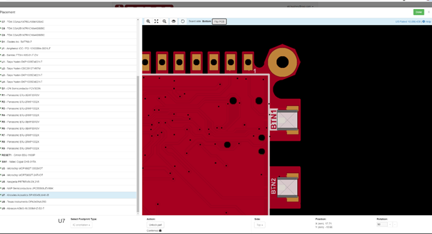

Along with the BOM, you must  upload XYRS placement data.    The XYRS data can be combined in the spreadsheet file used for the BOM.  The PCB:NG viewer will also show you where it thinks all the placements are and can make manual adjustments if necessary.
Figure 3 : PCB:NG Part Placement Interface

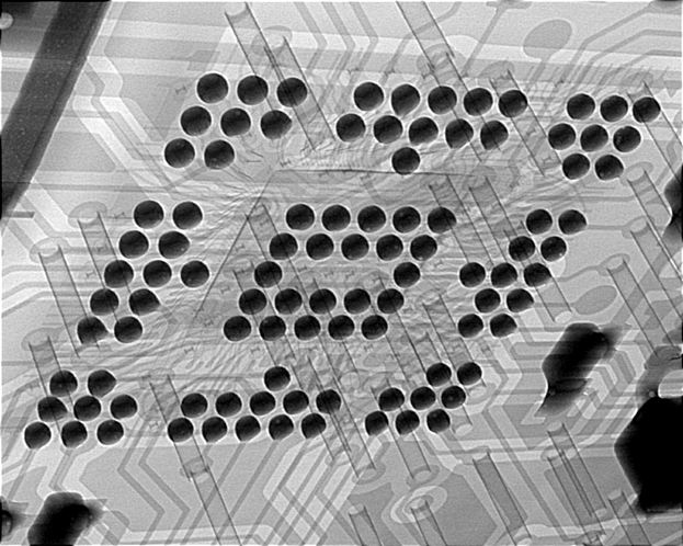

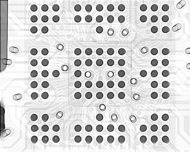

Figure 4: LPC55S69 VFBGA98 Post Assembly X-ray - View 1
Figure 5: LPC55S69 VFBGA98 Post Assembly X-ray – View 2
Figure 6: MEMS Microphone (LGA) Post Assembly X-ray
As you can see of the X-ray images, the solder joints were good.   It was also cool seeing the via structures in the PCB and bond wires in the IC packages.   You can even see tiny little via structures in the VFBGA98 package itself.   How did the build turn out?   Here is a video of the Mini-Monkey Rev B:
