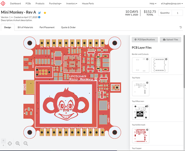

Getting your design uploaded is straightforward with PCB:NG.   You can upload your Gerber files and get a preview of the PCB.  As you move through the process, the web interface will give you an updated price:
Figure 1: PCB:NG Gerber Upload
The online PCB:NG interface includes a Design For Manufacture (DFM) check.  The check is exhaustive and includes all the common DFM rules such as trace width, clearance, drill hits etc.  In my case, I had some features that violated minimum solder mask slivers and copper to board outline clearances.  The online tool allows you to “ignore” DFM violations that may not be an issue.   I was able to look through all the violations and mark which ones were of no concern.

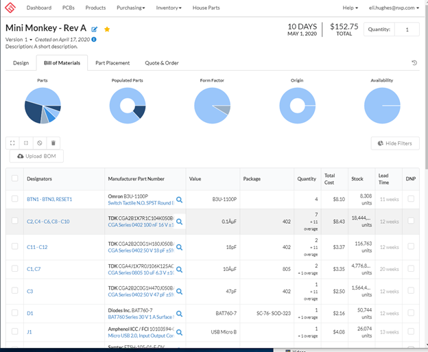

Once the Gerber files are uploaded, you can add your parts and as well as the pick/place data.  The PCB:NG interface will show you part pricing and availability as soon your Bill of Materials (BOM) is uploaded.   You have the option to mark parts as Do Not Place (DNP) if you do not want them populated.   In my case, I had 2 components on the Mini-Monkey BOM (a battery and a display) that I did not include as they required some manual assembly steps that I was going to perform once I had the units in hand.
Figure 2 : PCB:NG BOM Upload

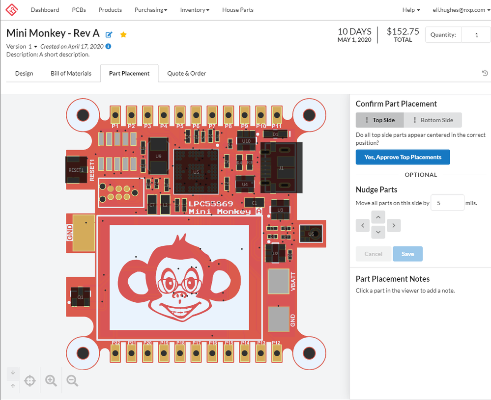

Along with the BOM, you must  upload XYRS placement data.    The XYRS data can be combined in the spreadsheet file used for the BOM.  The PCB:NG viewer will also show you where it thinks all the placements are and can make manual adjustments if necessary.
Figure 3 : PCB:NG Part Placement Interface

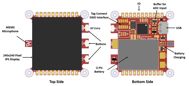

Highlights
  • Lithium-Polymer battery power with micro-USB Charging
  • High-speed USB 2.0 Interface
  • SWD debug via standard ARM .050” and tag-connect interface
  • Digital MEMs microphone with I2S Interface
  • 240x240 1.54” IPS Display with HS-SPI interface
  • Op-amp buffer for one of the 1MSPS ADC channels
  • 3 push buttons.  One can be used to start the USB ROM bootloader
  • External Power Input
  • 16MHz Crystal

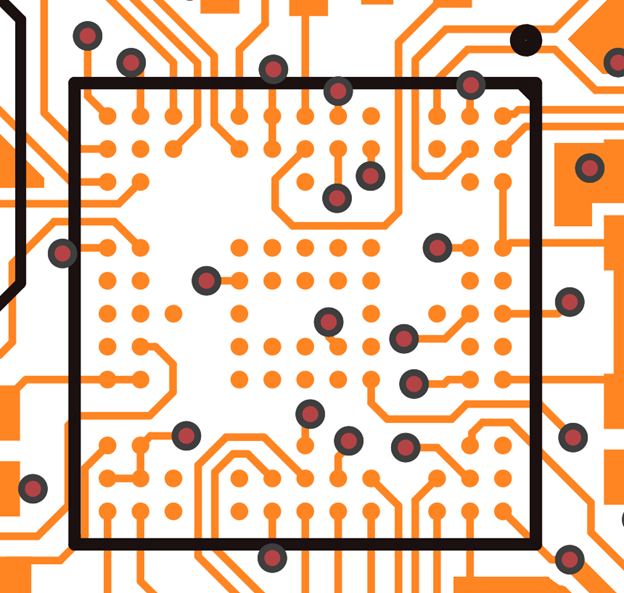

Figure 2.  Mini-Monkey VFBGA Fanout
As you can see, I did not make use of all the IO.       If I had used a 4-layer board I would be simpler to get quite a bit more of the IO fanned out.       Moving to smaller vias, traces and a 4-layer stack-up would probably allow one to get all IO’s connected.   For this design,  I was trying to move quickly as well as use the standard “prototype” class specs from Macrofab.    This means 5 mil traces, 10 mil drills with a 4-mil annular ring.  If you can push to 3.5mil trace/space,  NXP AN12581 has some suggestions.
