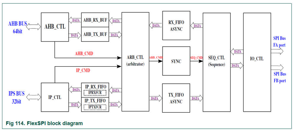

NXP FlexSPI Flash Controller
Built into the RT600 is a special flash interface controller called “FlexSPI”.   FlexSPI supports access to Single/Dual/Quad/Octal flash interfaces through the internal AHB bus.     This means the CPU can access SPI memory as if it were normal memory mapped flash.   The details of the SPI transactions are handled by the FlexSPI controller.    FlexSPI enables a wide array of memories to be connected to the MCU.  With FlexSPI, designers have access to extremely dense flash memories and can use new flash devices as they become available.   Designs can be easily scaled to storage requirements as needed.   SPI memories are also easy to route on a PCB as there are fewer connections.   Chapter 33 of UM11147 details the FlexSPI controller and possible use cases.
Figure 1.  NXP FlexSPI Memory Controller.
The FlexSPI controller has two ports which can be further subdivided into two separate interfaces allowing a maximum of 4 QSPI devices if needed.     To support future designs, the controller implements a look up table (LUT) that allow command sequences to be altered.       It is also important to note that in additional to flash, there are now SPI base (p)SRAM devices in the marketplace allowing for RAM to be added as well.

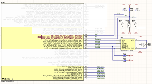

Figure 2.  QSPI flash connection on the RT685.
As you can see, QSPI memory is simple to connect.    I am using a +1.8v flash device.  Typically, I arrange my schematic symbols to be group functions by power domain to reduce the chance of error.  In this case, VDDIO_0 will be powered by +1.8v from the PMIC.   I left the connections to DMICs highlighted so you can see the intersection with FlexSPI B.  MCUXpresso includes a pin tool that allows you to plan the device muxing/pinout to reveal any potential issues.  With every new hardware design, I create a skeleton MCUXpresso software project that gets included in my hardware design git repository.  The skeleton project’s sole purpose is to define all of my IO as I am working through the hardware design.

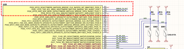

Boot Configuration

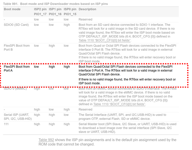

Once the flash memory is connected, there are two questions I always ask.    How does the CPU know to boot from this external flash and how to do I program the flash? The RT600 series shares a legacy with the LPC family of microcontrollers in that there are a few “ISP” pins which control the boot process.    These pins are sampled at power up by routines in located in program ROM.     One of the features of the LPC family of microcontrollers are ROM boot functions/utilities to allow programming over serial interfaces.  The RT600 continues this tradition and boot configuration is simple to set up.
Figure 3.  Selecting FlexSPI Port A on the ISP Boot Pins.
For the Super-Monkey module ,  I elected to use three switches to control the boot pins.   Note that the ISP lines are in the +1.8v power domain.   Setting the switches appropriately will allow to FlexSPI port A to be used for boot code.

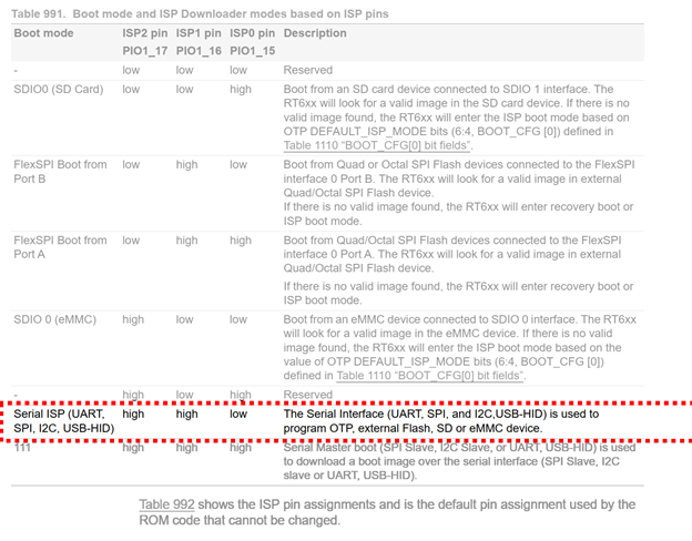

An important mode of the ROM bootloader in the RT600 is called “Serial ISP” which allow enables a PC/host to perform flash operations (and program OTP fuses) via interfaces such as UART or USB.   It is important to *always* allow this mode to be available in your designs.   It will save you lots of time and headache down the road.
Figure 5. Serial ISP Boot Mode.
Serial ISP can be your “escape hatch” when you are having issues or need a production programming/configuration interface.      At minimum, you should always provide access to the  UART lines on Flexcomm 0 (PIO0_1 / PIO0_2).

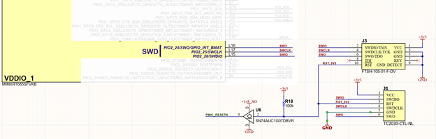

The last piece we need to look at is debug access.   The RT600 implements a standard ARM SWD interface.   On my 1st design revision with a new MCU, I always add the standard .050” ARM header for debug.    The only connections needed for a minimal configuration is SWDCLK and SWDIO.     Keep in mind that SWD trace IO are also available on the RT600, but I am choosing to use the simplest configuration.   The only extra feature I added was Serial Wire Output (SWO).  Once in awhile I will turn it on for streaming additional data through the debugger.  However, I found that simple SWD is often good enough.  I prefer to use Segger J-Link and their Ozone debugger but MCUXpresso can be used with a low-cost debuggers such as the MCU-Link.  There is quite a bit you can get done with simple 2-wire SWD and the available tools.
Figure 10.  RT600 Debug Connections

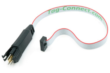

In additional to the standard 0.050" debug header, I always add Tag-Connect pads for debug access.   As the design progressed closer to the production build, the standard header can be added to the do not place list and the tag-connect header can be used if debug as needed.
Figure 11.  Tag-Connect SWD Cable

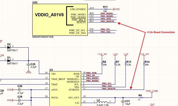

It should also be noted that the reset signal from the debug header may need a level translator.     The reset connection from the PMIC to the RT600 is in the always on +1.8v power domain.     IO Bank 1 in the Super-Monkey will be tied to a +3.3v rail.  A simple solution is to use a simple open-drain buffer to connect the reset line into the PMIC/RT600 reset.
Figure 12.  PMIC Reset Connection.
